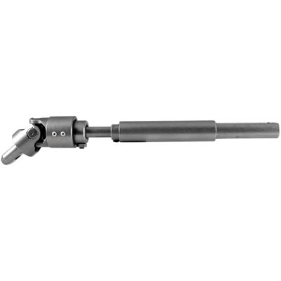

    Таки деталь номер 3 >:(
    Травмобезопасное соединение. Сам кардан живой, а вот его продолжение в виде трубы стучит. Кто разбирал? что там внутри? какая то телескопическая трубка?  :-X
    Chevy Clan!!!
    Chevy Tahoe the BEST
    Chevy Tahoe 2004.
    Оффлайн Eugene
    • Сообщений: 363
    • Откуда: Киев
    Re: Стук в руле круглая "таха"
    « Ответ #23 : Октябрь 23, 2009, 11:11:45 pm »
    Ребята!
    Я так понимаю это она родимая? Кардан с телескопической трубой. Для Тах Borgeson Universal 000937
    http://www.summitracing.com/parts/BRG-000937/?image=large
    Brand  Borgeson Universal
    Manufacturer's Part Number  000937
    Part Type  Steering Shafts
    Product Line  Borgeson Telescoping Steering Shafts
    Summit Racing Part Number  BRG-000937
    Collapsible  Yes
    Universal Joints Included  Yes
    Rag Joint Included  No
    Vibration Damper Included  Yes
    Shaft Style  Splined ends
    Steering Box Shaft Diameter (in)  3/4 in.
    Steering Box Splines  36
    Steering Shaft Material  Steel alloy
    Steering Shaft Finish  Natural
    Quantity  Sold individually.
    The Borgeson 937 Heavy Duty Replacement steering shaft is for the 1999–08 Chevy & GMC FULL SIZE TRUCKS & SUV's.
    Does your new Chevy or GMC have a “clunking or ratcheting” feel in the steering?
    Many do and Borgeson has the fix.
    Borgeson’s 937 steering shaft is a direct replacement upper steering shaft for 1999-2008 full size Chevy & GMC trucks and SUV’s.
    The Borgeson 937 Steering Shaft is constructed with a sealed billet steel needle bearing to provide the best vibration reduction possible and a heavy-duty telescopic shaft assembly.
    The 937 Shaft installs in about 30 minutes with basic hand tools.
     All Borgeson shafts are proudly made in the USA and carry a five-year warranty.
    Stop letting the dealer throw band-aids at your Truck. Get the Borgeson 937 Upper Shaft and get the best.
    BORGESON Universal heavy-duty replacement shafts are a vast improvement over OEM and can take anything you throw at them. Borgeson is so sure they’ll outlast your truck that they give you a Five Year Warranty. What makes the Borgeson assembly so much better than stock? It’s the precision, zero-play, sealed needle bearing U-joint machined from a solid steel billet. It’s not a cheap stamping like the OEM.
    BORGESON steering shafts telescope for easy installation and are permanently lubed and sealed. The telescoping shaft easily handles misalignment from body-lifts and extreme off-roading. Most OEM shafts have a similar coupler/flex-joint design, so Borgeson now has replacement shafts for Dodge, Chevy/GMC, Ford and Jeep. Some feature a vibration reducer to isolate road shock. Installation is easily done with common hand tools. The tight feel of the BORGESON steering shaft assembly will transform your truck!
    « Последнее редактирование: Октябрь 23, 2009, 11:18:44 pm от Eugene »
    Chevy Clan!!!
    Chevy Tahoe 2004.
    Оффлайн Eugene
    • Сообщений: 363
    • Откуда: Киев
    « Ответ #24 : Октябрь 23, 2009, 11:33:23 pm »
    По бренду DORMAN Part # 425176  {OE Solutions #19149105, 19153614, 88965505, 89060582}
    По виду смотрится проще Borgesonа
    Боргесон таки уселенный, но и в 4 раза дороже :o

    Различия оригинала и вала от Borgeson.
    Chevy Clan!!!
    Chevy Tahoe 2004.
    Оффлайн Roadster
    • Сообщений: 4109
    • зачОООтка: +151/-3
    « Ответ #29 : Октябрь 25, 2009, 01:58:14 pm »
    оригинальный это черненький, а боргессон с гайкой?
    Поменял уже? Много разбирать надо?
